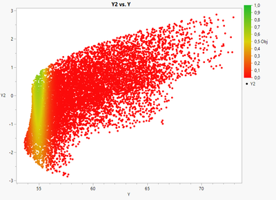

What you can do to better visualize this situation is to use the Simulator to generate data points from your model, covering your factors ranges with enough points and random uniform distributions. The resulting datatable will contain the predicted responses, as well as  an "Obj" column, containing the overall desirability score.
You can then plot the data points from this table, and see where are the optima located. You'll probably see that there are several combinations that can help you reach an optimum (here an example with two responses for three factors), a Pareto front :
The other option consists in doing the "Maximize and Remember" option under "Optimization and Desirability" several times with different starting points. But this is hard work, and may be not completely exhaustive and prompt to errors.
Hope this Pareto front solution may help you,
