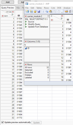

I am pulling data from an SQL database. In the updated preview it looks good, but when I run the query, not all of the values fill in properly. Any idea what is happening with this?

It was an older MySQL driver issue. Now having to use 2 drivers for MySQL. One for JMP and one for the internal database. It works!
The newer driver for JMP fixed the issue I was seeing. I went through several drivers until I finally got to one that worked. JMP also doesn't like if the driver is too new, so there seems to be a sweet spot with MySQL 5.2.
