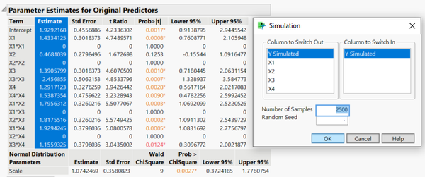

Hello everyone, so I have been testing around with the simulation feature in JMP, which you can use to simulate statistics from reports where you have a random component (Overview of the Simulate Feature (jmp.com)). To the best of my knowledge, you can only simulate one column at a time. Is it possible to perform the simulation for the whole output table instead of having to simulate each column of the report separately? And if not, do you maybe have ideas for making the procedure of simulating each column separately less tedious?
Thank you very much for your input!
Best Sam

Sorry for the screenshot not working, here you go:
