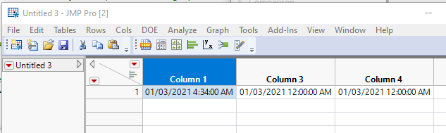

Here is one way to handle it, assuming that the S2 value is in a column called Column 1 in the JMP Data table
Informat( Short Date( :Column 1 ), "mm/dd/yyyy" )
Here is another
Date MDY( Month( :Column 1 ), Day( :Column 1 ), Year( :Column 1 ) )

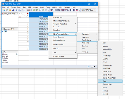

I assume you mean round to the date so you can tabulate over it.
formula: :Column1- Time Of Day( :Column1 )
or: right click on the column header --> New Formula Column --> Date Time --> Date will do the same
