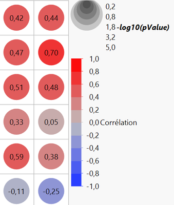

Hello, I'm sending you a message regarding the correlation matrix
It is possible to display circles of significance in this matrix (as below in the photo)
Inside these circles is displayed the correlation value between two variables and the color corresponds to a more or less strong correlation
However, I don't understand the size of the circles and the scale used (log10 (pvalue))
Does anyone have an explanation? I did not find anything on the community
Thank you

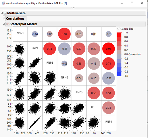

Definitely not sure about this but:
Significance Circles
Shows or hides correlation circles in the upper right triangle of the scatterplot matrix. The color of each circle represents the correlation between each pair of variables on a scale from red (+1) to blue (-1). The size of each circle represents the significance test between the variables. A larger circle indicates a more significant relationship.

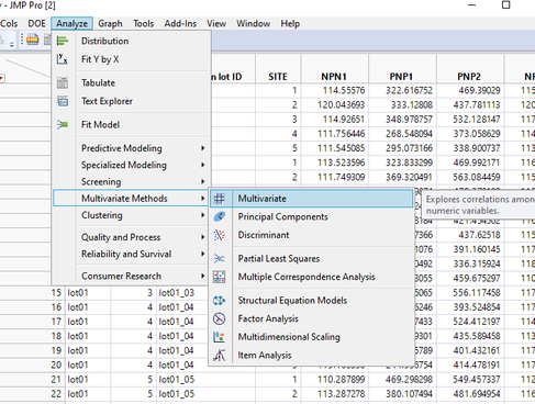

@jthi Points you towards the current solution in JMP 15.2 for the creation of your correlation circles.  You can find it under Analyze pull down menu.
It can produce output close to what you want
Lacking is the consistent circle size and the -log circles.  JMP 16 will bring some good enhancements.

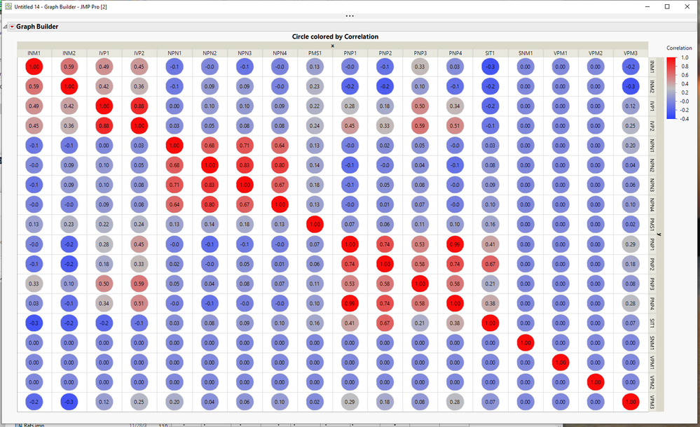

However, just for fun, I wanted to see if I could get JMP to create a solution with static circle size.
This was all done interactively.....no scripting

  1. Run the Multivariate Platform to create the correlation matrix.

  7. Ran Graph Builder to produce the desired output seen above
