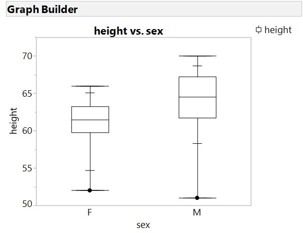

As the one-page guide shows, those box plots were created with other platforms in JMP: Analyze > Distribution, Analyze > Fit Y by X.
You can create box plots with quantiles in Graph Builder by changing the box plot type (lower left in the Graph Builder window).
I hope this helps.
Regards,
Phil

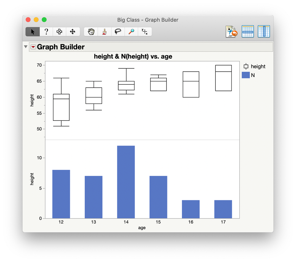

Your situation might be addressed by adding a plot of N for each group. That result is easily accomplished with Graph Builder:

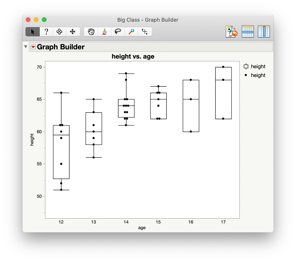

Screen Shot 2020-10-30 at 5.35.14 AM.pngScreen Shot 2020-10-30 at 5.35.14 AM.png
Or perhaps include the markers for the data to get a sense of the group sizes.

The best solution depends on the particular details of your data, of course.
