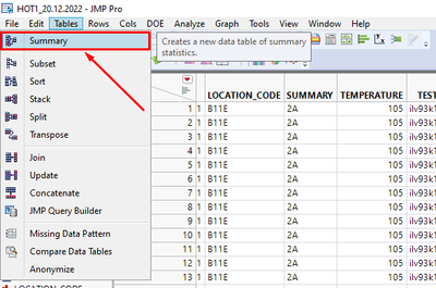

I'm using a lot in function as "Summary" or "Split" in my current position.
And I try organize shortcut keys to these functions and I didn’t find this option in JMP...

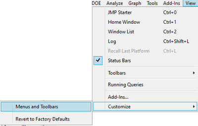

Hi @Dennisbur , you can find the settings under View/Customize/Menus and Toolbars

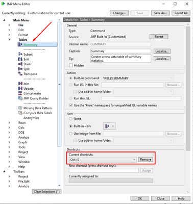

I have determined the shortcut key for the "Summary" function as Ctrl+S
But when I press Ctrl+S in any data table, nothing happens.
I tried to restart JMP again, and it didn't help.
Did I miss something in the process?

Unfortunately, some of the standard Keys cannot even be removed.
I tried to replace Ctrl + T (new script) with my own command (containing a default script)  - but new script is stronger.
Re: Shortcut Keys
It appears JMP doesn't like to re-assign Ctrl+S as a shortcut key, as that is hard-wired to the File...Save command. I verified that trying a different combination (Ctrl+Alt_Shift+S, for example) works just fine.

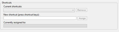

I just tried to assign ctrl+shift+D. Pray tell what the windows gods have decided that is a critical hotkey for? Are we sure the issues with hotkey assignment are limited? If so, it would be very nice to know which exact combos/keys cannot be used. If I try and type ctrl+shift+D into the command I want - it simply makes no entry. That is a horrible way to tell someone that it can't be used, because it's the same observation you'd get if a) something was frozen on the page or software, and b) your wireless keyboard was disconnected or its battery dead. I have decided finding hot keys that DO work is easier than trying to figure out why some DON'T work.  :)
