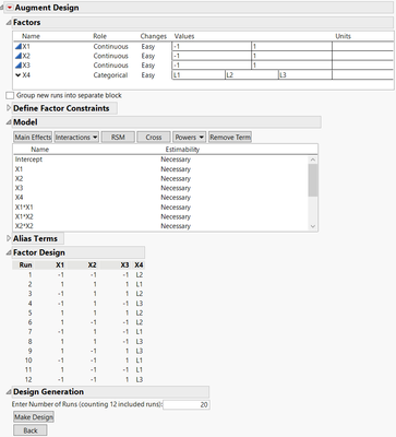

Even if the option "Add Centerpoints" is unavailable, you may be able to continue with your design augmentation by choosing "Augment", and from there in the "Model" tab click on "RSM" to augment your initial screening design in a Response Surface Design with 2-factors interactions and quadratic effects terms :
