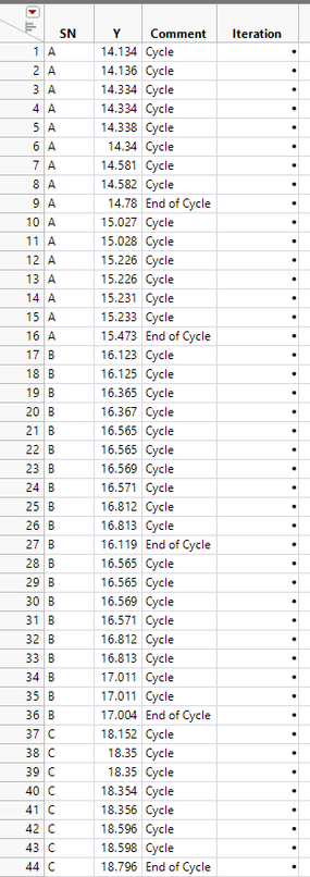

Im trying to create a column which assigns an iteration number (numeric and continuous) based on column "Comment = End of Cycle" and increments it for the same SN. The number of data points for each SN is not the same.
For example.
for SN = "A", rows 1-9: Iteration =1, rows 10-16 Iteration =2
for SN = "B", rows 17-27: Iteration =1, rows 28-36 Iteration =2 and so on...

Thanks for the response. Sorry had to be more specific. I dont need an additional column by the name of iteration count. I wanted the formula for the iteration to assign a number and increment it based on the "end of cycle" comment. Below is the image of what i wanted the iteration column to look like.
Im attaching the jmp file per the request.
