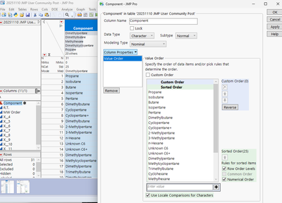

I have an interesting value ordering/labeling problem. See attached files. The data come from a gas chromatograph. The order that matters is not the alpha-sort of the name of the compound but the retention time (R.T.). There are 31 compounds = manual value ordering of the Compound column or manual value labeling of either the R.T. or MW Order columns will be painful and error-prone. Anyone working with chromatographic or spectral data probably has the same issue...
Is there a dialog-driven way to set the value labels or order by referring another column as reference?
Alternatively, does anyone have a script that can do this?

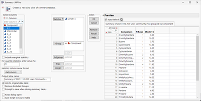

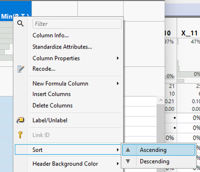

You can do this also manually
Create summary table (use the statistics as necessary)
Sort your data
Set value order to the column you wish to order in the summary table
Copy Column properties from the summary table and paste to your original table
(I use modified scripted version of this process)
