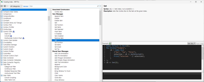

Scripting Index is usually good place to start
