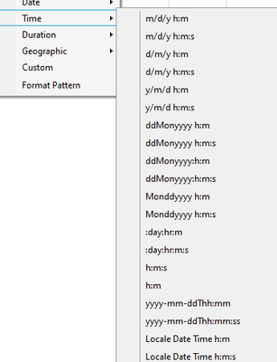

With the date issue could also be with this format:
Format("y/m/d h:m:s"),
JMP can be a bit finnicky with formats from time to time. You could remove the formatting from the "b" column and see if it fills the row with datenum value. Then you can try to see which formats you have available from format menu.
