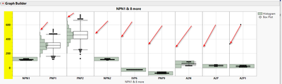

Is there a way to have a separate Y-axis for each parameter in the graph builder in the parallel independent combination?

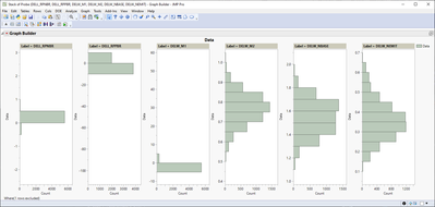

Combine scale - Parallel merged.
I want to have a separate Y axis for each parameter below

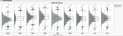

Combine scale - Parallel independent
Names Default To Here( 1 );
dt = Open( "$SAMPLE_DATA/Semiconductor Capability.jmp" );
dt << Graph Builder(
	Size( 1146, 347 ),
	Show Control Panel( 0 ),
	Variables(
		X( :NPN1, Combine( "Parallel Independent" ) ),
		X( :PNP1, Position( 1 ), Combine( "Parallel Independent" ) ),
		X( :PNP2, Position( 1 ), Combine( "Parallel Independent" ) ),
		X( :NPN2, Position( 1 ), Combine( "Parallel Independent" ) ),
		X( :IVP6, Position( 1 ), Combine( "Parallel Independent" ) ),
		X( :PNP9, Position( 1 ), Combine( "Parallel Independent" ) ),
		X( :A2N, Position( 1 ), Combine( "Parallel Independent" ) ),
		X( :A2P, Position( 1 ), Combine( "Parallel Independent" ) ),
		X( :A2P1, Position( 1 ), Combine( "Parallel Independent" ) )
	Elements(
		Histogram(
			X( 1 ),
			X( 2 ),
			X( 3 ),
			X( 4 ),
			X( 5 ),
			X( 6 ),
			X( 7 ),
			X( 8 ),
			X( 9 ),
			Legend( 4 )
		Box Plot(
			X( 1 ),
			X( 2 ),
			X( 3 ),
			X( 4 ),
			X( 5 ),
			X( 6 ),
			X( 7 ),
			X( 8 ),
			X( 9 ),
			Legend( 5 )

jthi
Re: Seperate Y axis for Parallel Independent in Graph Builder
I don't think you can do it with split data in graph builder without any scripting. In JMP18 you can use Page with stacked data to create something like this when you modify how many reports you show in single row
-Jarmo
