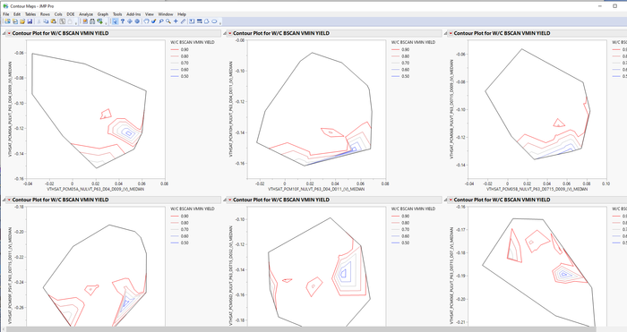

Re: Semiconductor WAT contour
Here is an attempt to get the contour maps displayed.  The complexity is in finding the matching columns.  The column names are inconsistent.  The below script illustrates the kind of things that you will need to do,  to do a better job of matching the columns.  The script has been annotated to allow better understanding of what is being used to attempt the matching

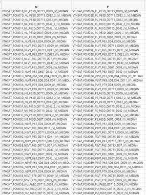

txnelson
If the issue is matching the N vs. P columns, a script can produce that.  Here are the matches I found.
I have attached the data table with the complete list I came up with.
If I am on the right track, can you provide what the graphic you are looking for would be for one of these pairs?
Jim
Jony
Level II
Thank you for your reply,The attachment is my raw data, main include yield column,and many X columns,I need to draw contour graphic,that is X axis is N-device,Y axis is P-device,and Yield as Z, for single device I can easy to draw contour map,But I can only draw one map at a time,I want to draw all countor maps at once.
txnelson
