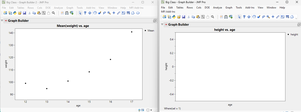

Hi everyone,
I'm probably missing something obvious here - but I'm struggling with a special selection case.
I have one plot controlling the content of another plot:
  • If I select 3 points, I get 3 curves displayed.
  • If I deselect 2 of those points, only 1 curve remains.
  • So far, everything behaves exactly as expected.

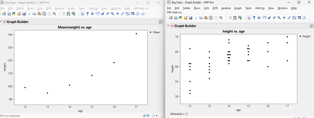

However, when I deselect the last remaining point, so that nothing at all is selected, JMP suddenly displays *all* curves again.
I understand the logic: "no selection" is interpreted as "no filter", therefore all rows are shown.
But in my use case, I would actually expect the opposite behavior:
if nothing is selected, then nothing should be displayed.
This is not a cosmetic issue, it causes JMP to orbit for 5 minutes - and it produces a messy (useless)  plot.
Is there a hidden workaround?

You can also create this type of "filtering" using selection column with Forced Values (0/1) + Formula (such as Col Sum(Selected(), :age) >= 1 , depending on your selection graph) and then add local data filter with the selection column value being 1.

First, I used standard Graph Builder plots together with the Filter By functionality in the Dashboard.
But it shoed the described issue.
As a workaround, I now create the plots manually:
  • Empty plot with a Graphics Script
  • Retrieve the selected rows
  • Generate the curves in the second plot "manually"
 Another alternative:
  • Do not use Filter By
  • Instead, update the selection in the second plot whenever the selection changes in the first plot
These workarounds allow you to explore the flexibility and possibilities of JMP.
However, a small toggle: Nothing Selected actually means “Nothing Selected"
would feel much more consistent with the JMP user experience.
It’s just that I can’t seem to find such an option.
