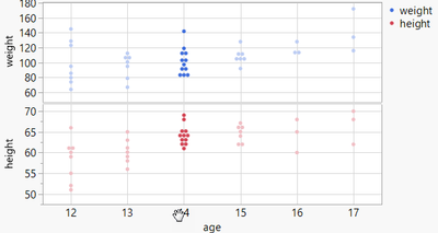

In Graph Builder, is there a possibility to select the data points via a (Shift, Alt, Ctrl) click on a label of a categorical/ordinal axis?
i.e. by clicking on "14", all data points corresponding to age=14 get highlighted:

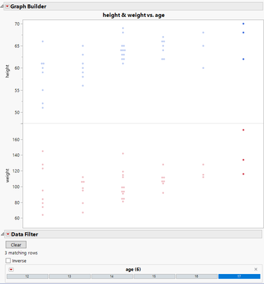

I like your heatmap idea better, but here's something that almost works and might help drive the discussion forward. I was thinking that a data filter instead of the axis would work, but I couldn't find a way to get rid of all the controls.

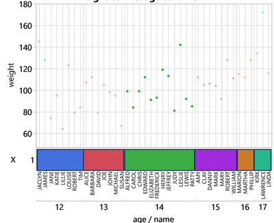

Add-On topic:
If several columns are used as hierarchical X labels, there is an option for each subplot and plot style to use or not use the respective column as part of the hierarchy.
This can be extremely useful:

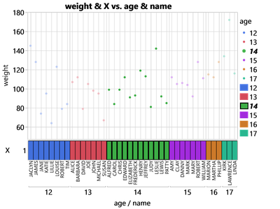

by deselecting the column which is used as 2nd level on the X axis, Heatmaps will just be separated by the 1st level, like this:
Unfortunately, deselecting a column doesn't have any effect - the graph looks exactly the same with "X - name" selected and deselected :(

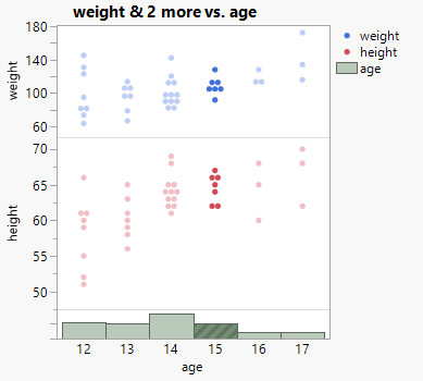

Old topic I know, but I echo @Mark_Bailey's comment about histograms, here is an example:
JSL to recreate this graph:
View more...
