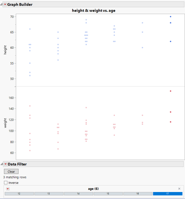

I like your heatmap idea better, but here's something that almost works and might help drive the discussion forward. I was thinking that a data filter instead of the axis would work, but I couldn't find a way to get rid of all the controls.

dt = open ("$SAMPLE_DATA/Big Class.jmp");
nw = New Window( "Graph",
V List Box(
g = Graph Builder(
Size( 754, 634 ),
Show Control Panel( 0 ),
Show Legend( 0 ),
Show X Axis( 0 ),
Show X Axis Title( 0 ),
Variables( X( :age ), Y( :height ), Y( :weight ) ),
Relative Sizes( "Y", [127 128] ),
Elements( Position( 1, 1 ), Points( X, Y, Legend( 18 ) ) ),
Elements( Position( 1, 2 ), Points( X, Y, Legend( 19 ) ) )
df = dt <<
Data Filter(
Location( {2831, 76} ),
Width( 741 ),
Add Filter(
columns( :age ),
Where( :age == 17 ),
Display( :age, "Blocks Display" )
df << show controls (0);
