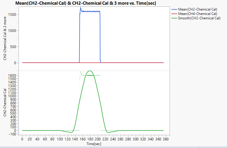

I create a graph, and when I go to select a portion of it, it highlights the entire excel sheet. I remember from demo that you should be able to select a segment and have it only highlight the data directly relating to that segment. What am I doing wrong here?
I would also like to know if there is any way to have JMP find the peak data from multiple points on the same line and display them in the graph?

Trying a slightly different tact, I got rid of the part of the script that adjusts the size and appearance of the dots and simply changed those settings in my preferences for now, I realized that the script I had prior to that was not actually putting the points on to the additional graphs (more than the first) so I came up with this one. However it is doing some rather bizarre thing where it plots out a second graph of the first line completely on it's own in smooth...

I saved the script for this, and then the script for how I want it to look (just the top graph) but I am not certain what parts I need to edit to get rid of the eroneous graph...
//This is what it graphs
Graph Builder(
	Show Control Panel( 0 ),
	Variables(
		X( :Name( "Time[sec]" ) ),
		Y( :Name( "CH2-Chemical Cal" ) ),
		Y( :Name( "CH4-Chemical Cal" ), Position( 1 ) ),
	Elements(
		Position( 1, 1 ),
		Line( X, Y( 1 ), Y( 2 ), Legend( 7 ) ),
		Points( X, Y( 1 ), Y( 2 ), Legend( 8 ) )
	Elements(
		Position( 1, 2 ),
		Points( X, Y, Legend( 11 ) ),
		Smoother( X, Y, Legend( 12 ) )
	SendToReport(
		Dispatch(
			"CH2-Chemical Cal",
			ScaleBox( 2 ),
			{Min( -125.45871559633 ), Max( 1724.54128440367 ), Inc( 100 ),
			Minor Ticks( 1 )}
// This is what I want it to graph
Graph Builder(
	Variables(
	Elements(
