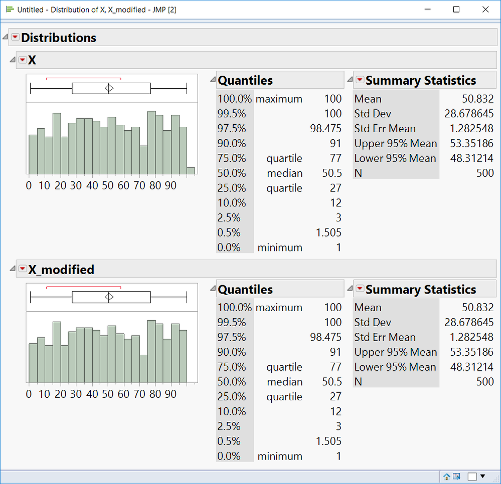

An easy, klugey fix would be to subtract a really, really small number off your data points so that the 100 becomes 99.9999999 or something similar.  Here's an example where I only subtracted off of the values equal to 100 in a new column I called X_modified.  You see the histogram for the original column X (contains random uniform(0,100) values rounded to integers).HistogramProblem.PNG
Originally, the Quantiles table for X_modified showed the max value = 99.99999999.  I addressed that by reducing the the number of digits in the format for that column from 12 to 6.  You can change the format by double clicking on the column.

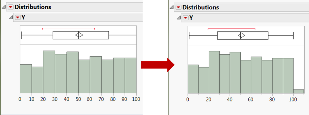

I created a data set to mimic yours. If I double click on the x-axis to get the axis dialog box I set the min = 0, max = 100, increment = 10, and #minor ticks to 0 to get bins of size 10 with the axis running from 0 to 100. You can also use the hand tool (one of my favorite tools for historgrams) to resize the bins (swipe up for more bins, down for fewer, left and right to change where bins start).

I also tried to play with the axis settings, however if you set the min to 0 and the max to 100 it will just hide the last bin. If you use then the handle tool to change the scale of the axis the last bin appears. Did I miss something?

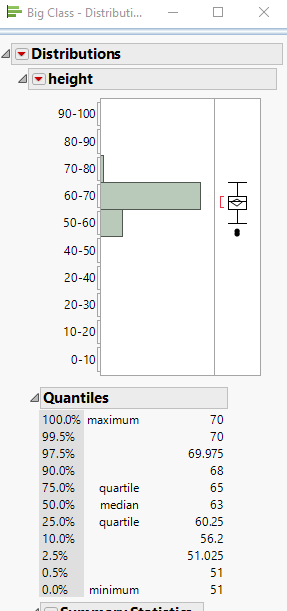

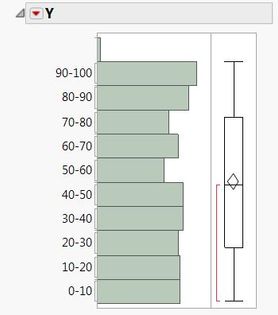

I think you may be able to get what you want by using a combination of Value Labels with ranges and the Hand Tool.  I set the Value Labels to the bins that I wanted, and then used the hand tool to move the scale and bins to what I wanted......see below

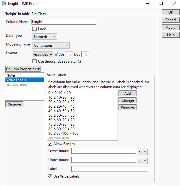

Using the labels is a good idea! Unfortunately I am not able to reproduce exactly what I want.
First I set the Value Labels so that the 100 values should be included in the last bin:

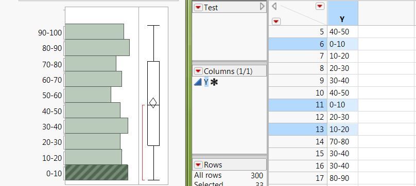

But  I still have an additional bin for the 100 values:
If I use then the hand tool, the first bin is associated to "0-10" and "10-20" values which is a bit confusing:
