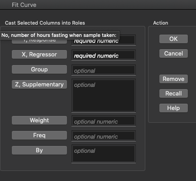

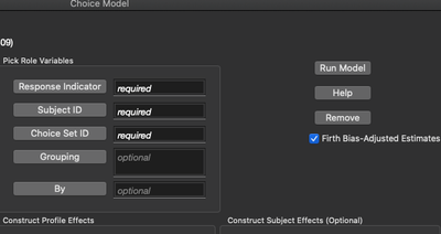

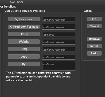

Hi, i am just a beginner using JMP, still getting familiar with it. See pics attached. These are the ones I meant. But I think I know now how to do scripts in JMP.

Ah......yes the examples you attached are examples of single response variable analyses.  Below, is an example of taking 1 of your examples, Fit Curve, and generating 127 analyses, each with a different response variable
