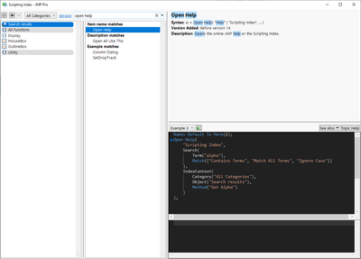

I would like to teach a class on JSL using the Scripting Index. Is there a way to filter the items list based on sorted array of topics? Or where is the Name, Description, JSLExample code located, thinking about recreating the window. Was trying to avoid recreating the wheel and copying the description and code out to separate files. Would like to re-use what is already in place.

You might be able to do quite a lot utilizing Open Help()
