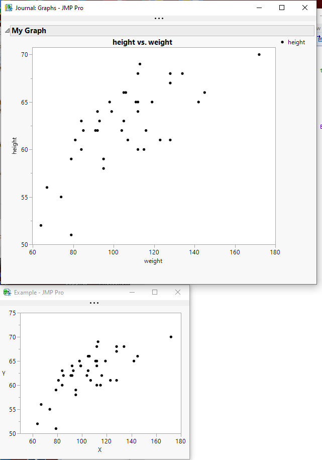

Here are a couple of ways you can get what you want.  The first one can use any of the JMP platform graphics and just strip off the graphical portion and paste it into a new window.  The second example creates a new graph from scratch, using the JSL graphics primatives
Names Default To Here( 1 );
dt = Open( "$SAMPLE_DATA/big class.jmp" );
// Create a Graph Builder that does not have a red triangle
gb = dt << Graph Builder(
	invisible,
	Size( 528, 456 ),
	Show Control Panel( 0 ),
	Variables( X( :weight ), Y( :height ) ),
	Elements( Points( X, Y, Legend( 6 ) ) )
nw = New Window( "Graphs", <<journal, ob = Outline Box("My Graph") );
ob << append( Report( gb )[Picture Box( 1 )] );
Report( gb ) << delete window;
// Create a graph using the JSL graphic primatives
New Window( "Example",
	Graph Box(
		Y Scale( 50, 75 ),
		X Scale( 50, 180 ),
		Marker(
			Marker State( 0 ),
			dt:weight << get values,
			dt:height << get values

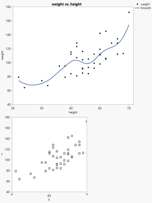

You might consider using graph builder to build your charts and then just copying the content to another box.  Here is an example which both uses graph builder and the Graph Box function to construct graphs in a new window without the red triangle.
names default to here(1);
dt = Open( "$Sample_data/Big class.jmp" );
//Make graphs using graph builder
gb1 = Graph Builder(
	Size( 534, 456 ),
	Variables( X( :height ), Y( :weight ) ),
	Elements( Points( X, Y, Legend( 2 ) ), Smoother( X, Y, Legend( 3 ) ) )
//then use the graphs boxes in other windows:
win = New Window( "Plot examples",
	graphbuilder = (gb1 << XPath("//GraphBuilderBox"))[1],
	graphbox = Graph Box(
		Frame Size( 300, 300 ),
		Marker( Marker State( 3 ), :height << get values, :weight << get values );
//close graph builder
wait(0);
gb1 << close window;
//set axis limits for manually created graph:
(graphbox << XPath("//ScaleBox"))[1] << {Min(50), Max(70)};
(graphbox << XPath("//ScaleBox"))[2] << {Min(40), Max(180)};
