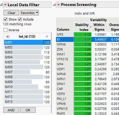

Is your filter working correctly for process screening? I did simple test using jmps sample data.
Filtered to only lot01

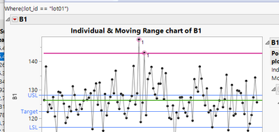

and when I create control chart for selected I can see it has been filtered
The control charts will open in a new window. To capture that you can use << get window list + << get window title and check which is your window. It is named "Selected Charts" if more than one is created AND "Selected Charts" doesn't yet exist
