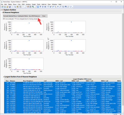

For a first data exploration, I am looking for a solution so the users can interactively filter all anomalous rows.
One simple approach is to conduct a KNN outlier analysis (unchecking the option of imputations and being able to change the default number)
And save the distances to each NN, so a global score can be obtained (e.g., by adding all distances into one column).
How can automate these steps that have GUI actions in JMP 16?

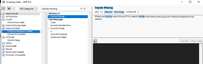

I usually start my looking for same names from Scripting Index (and in this case it might work)
Only thing I'm not sure about is Impute Missing part

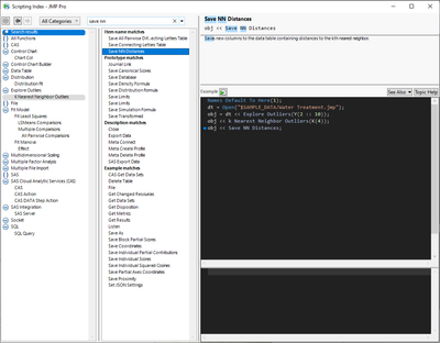

obj << k Nearest Neighbor Outliers(K(4));
obj << Impute Missing(0);
obj << Save NN Distances;
