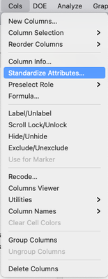

You could write a script to do that but it's not necessary. Select the columns you want to change and choose Cols->Standardize Attributes. That will let you change data type, modeling type, column properties, etc. for many columns at once.
