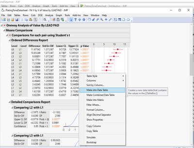

You can import the Analyze result to a table (Then create a table that has group names, means, std errs, lower and upper 95% bounds, and p values of each group).
