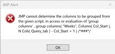

I have a set of data (weekly order volume) that I'm tabulating and then stacking.  This script works fine if I run it pieces at a time.  However, when I try to execute it as a whole I get the following error.  Any ideas?

How big starting table you have? How big tabulate do you end up with? Does the script work properly if use values instead of variables with the group columns?
You could try adding data table reference to Column instead of relying on current data table, so use
Column(Query_tab, Col_Start)
Also if Data Table("SO Query") is same as Query = Current Data Table(), I would replace it with dt to make it more robust.
-Jarmo

try
Query_tab = Query_piv << Make Into Data Table;
wait(0);
The issue may be caused by JMP performing the grouping action before the data table has been populated.

I tried wait there.. I also tried it after Col_start = 5.  No luck.

Hmm, I cannot reproduce the issue with some dummy data. It might be a timing issue, but why doesn't wait(0) work?
You could skip the grouping step and use the column references directly as input for Stack.
Remove from() to start with column #5.
Query_tab = obj << Make Into Data Table;
cols = Query_tab  << get column references;
Remove From( cols, 1, 4 );
Query_tab << Stack( columns( cols ) ) ;

Adding the table reference solved the problem.  Thanks!!
