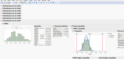

Hi All,
I would like to create a script for below distribution. Where should I edit in the script to have "by" grouping.
And if I just want to display lot_id=lot01 how can I filter that in the script
mylifemyrule_0-1686831450787.png.
Appreciate if anyone can help me on this.

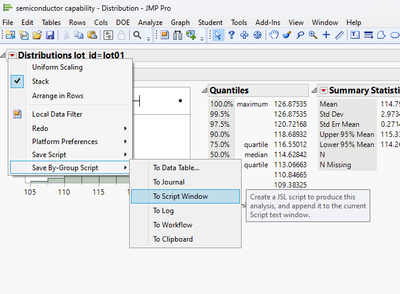

Re: Script for distribution plot ( multiple column and group by row name)
All you have to do is to run the Distribution platform as you want it to be, and then go to the red triangle and select
    "Save By Group Script"
and it will give you the script with the By element included.
Distribution(
	Stack( 1 ),
	Continuous Distribution(
		Column( :NPN1 ),
		Horizontal Layout( 1 ),
		Vertical( 0 ),
		Process Capability( Use Column Property Specs )
	By( :lot_id )
Jim
