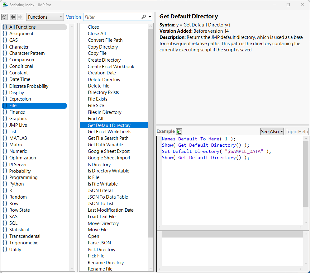

Re: Saving the file path of a user prompted Open() command
Using the Open() function with a file name will use the relative path. The default path can be found by call Get Default Directory().
