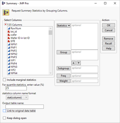

I have a table with 400k+ rows and in my analysis I have created a summary table.
I do a fit Y by X on the summary table and get what I expect.  From the pull down I select "Save Residuals" and the new column is not created on the summary data table, but on the original data table.  Is this the intended operation?  The work around is to separately save the summary data table to break the linkage.  Or is this a bug?
Andy
4 REPLIES 4
txnelson
Re: Save Residuals to Summary Table Problem
The issue is that your summary data table is linked to your original data table.  What you need to do, is to unselect the Lint to Original Data Table checkbox when you create the summary data table:
