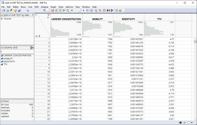

I have two columns in the file, one column is the parameter name, the second column is the parameter value, I want to confirm whether JMP can make a definition: different parameter names corresponding to the parameter value has a different numerical format. For example: the parameter name is TTV is an integer format, and the parameter name is CARRIER CONCENTRATION and RES is a scientific notation.

Most likely you would want to split your table and have different formats in different columns
Otherwise I think you would have to rely on Best format.
Edit:
You can read a bit more about numbers/strings in JMP from Scripting Guide and JMP Help and finally JSL Syntax reference of Format (note that Format function will return text)
