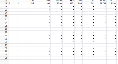

Ah, it seems that I had some non-blank rows at the bottom of my second data table.  Not sure why that was the case, but I removed them - and it worked.  Please see snip below.
