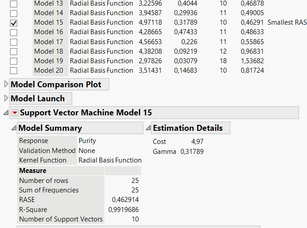

Hi Victor, this tuning design works great,  I want to model a guality response Y as a function of three Y FPCA's from NIR spectra (FDA). I tried neural network but even with 3 TanH nodes profiler shows to my opinion too high and irregular ncurvature. SVE after tuning does a nice job, I support vector machine learning!

In your screenshot, it seems the optimal SVM model found with the Tuning design is quite interesting :
  • It uses 10 support vectors, so less than half of the points are used to build the "boundaries"/vectors used in SVM model, which may be a good sign of low complexity and good generalization properties,
  • The curvature value (gamma) is quite low, so the response profile and boundaries may not be over-complex and highly curved (so again, low complexity and good generalization properties),
  • The penalty (cost value) seems quite high, but with a low-size dataset this is often the case in practice, as any misclassified/mispredicted point will greatly increase the misclassification rate/RMSE : 1 misclassified point out of 25 = 4% misclassification rate, compared to higher dataset size where one misclassified point would represent less than 1% misclassification rate. In some situations, it can be interesting to choose a model with a slightly larger error (RMSE/Misclassification rate), but with a lot less support vectors : you degrade your predictive performances on the training set in favor of a less complex model that could be able to generalize better on new data.
You can use the table generated by the Tuning design, with the performance metrics, to better assess the relative importance and contribution of the two hyperparameters on the performance metrics (Misclassification rate for classification, or RASE and R² for regression).
As always, it is recommended to validate your model with new validation points, to make sure your model doesn't overfit.

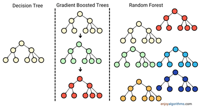

Here is a short visual between the different tree-based models (I don't like how the individual trees in the Random Forest have the same structure, but it's a simplistic schema):
To answer your question, I would try Random Forests over Boosted Tree methods on low size dataset like DoE, to have more confidence in the results, use an algorithm less prone to overfitting, and have better generalization properties.
