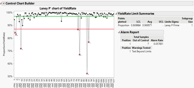

I noticed that when I'm using Control Chart for Attribute, I cannot turn on Sigma Report.
How can I display how many N in this chart without using scripting?
The N value is important for us to communicate to management & analysis can be replicated without scripting.
(If in Control Chart for Variable, the Sigma Report will show the N value. So, we could say 7 lots will fail out of how many)

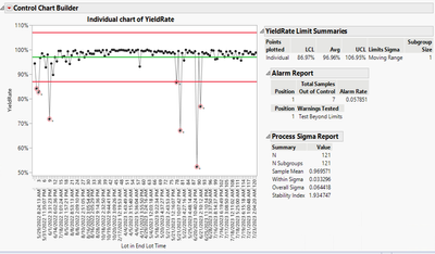

Thank you @jthi for the suggestion.
Since it only available in variable chart, then I would just use I-MR chart (without MR).
The calculated limits & alarm rate are the same (I think it is because the Laney's method normalize the MR to estimate the sigma then transform back).
Three-way chart is a powerful tool (for analyst) but it's hard to get high-level people to understand it.

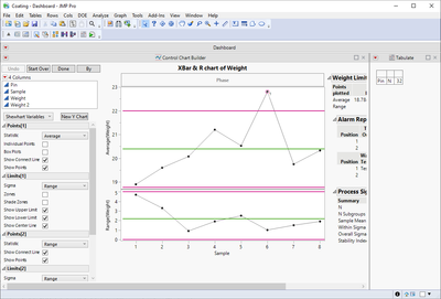

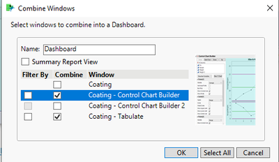

Maybe you could for example use other platform to calculate N (Distribution/Tabulate/...) and then use Combine Windows to combine them to create a Dashboard
