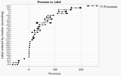

Is is OK for you to stack the data?
Then you can use "order by" via a manually calculated column:
dt = Open( "$SAMPLE_DATA/Semiconductor Capability.jmp" );
dtstacked = dt  << Stack(
	columns( Column Group( "Processes" ) ));
dtstacked << New Column( "median",
	Formula( Col Quantile( :Processes, 0.5, :Label ) ),
dtstacked<< 	Graph Builder(
	Variables( X( :Processes ), Y( :Label, Order By( :median ) ) ),
	Elements( Box Plot( X, Y, Legend( 13 ) ) ),
	Local Data Filter(
		Add Filter(
			columns( :Label ),
			Where( :Label == {"A1", "A2N", "A2P", "A2P1", "B1", "B10", "CAP"} )

In JMP there are always multiple ways to get where you want : )
Another alternative: sort the columns with ascending order of the values.
When you know the order, this can easily be done via "group".
Just open Graph builder and drag the group "sorted" onto the Y axis.
Up to 14 columns are possible till JMP changes the mode to "parallel plot".
Names Default to HERE(1);
showN Cols = 14;
Try(close(dt, noSave));
mysummary = dtstacked  << Summary(Group( :Label ),Median( :Processes ));
sorted = mysummary << Sort( By( :"Median(Processes)"n ), Order( Descending ) );
mycols = sorted[1::showNCols,"Label"];
dt << Group Columns( "sorted", mycols );
