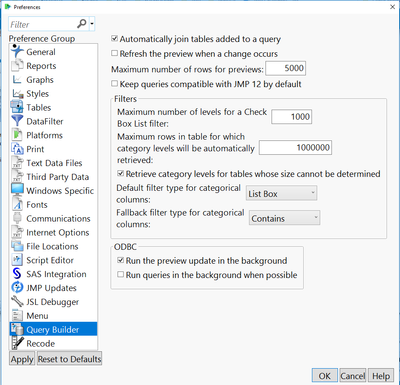

Re: Run several database queries (ODBC) in background and combine data afterwards, how to control running queries?
There is an ODBC setting in preferences that has lead to similar misbehavior for me. If "Run queries in the background if possible" option is checked then uncheck it and try your script again. I think there is a trade-off of speed for stability in doing this, but worth experimenting with if you have not already.
