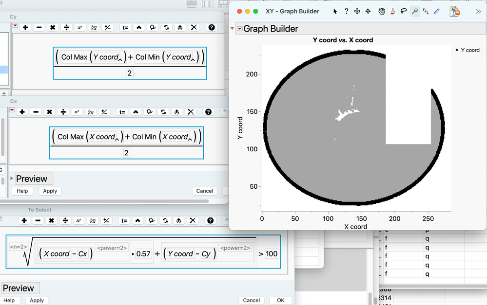

This might be an iterative process. it is also tough, in a pixellated environment like this, to strictly define "3 from the edge".
You can get pretty close by using an ellipse to select.
1) find center x and center y
2) using eccentricity as needed, perturb a circle to get an ellipse parallel to the wafer edge.
3) choose a "radius" (dubious term here, I know) that selects the points you want.
4) use a formula column to flag points of interest.

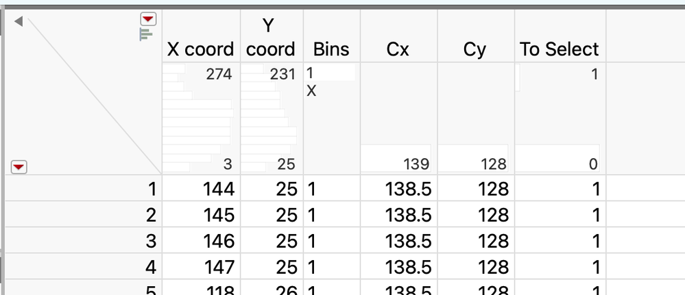

Below are screenshots and a script to run against your data table
Names Default To Here(1);
dt = current data table();
dt << new column ("Cx",  Formula( 	(Col Max( :X coord ) + Col Min( :X coord ) ) / 2 ) );
dt << new column ("Cy",  Formula( 	(Col Max( :Y coord ) + Col Min( :Y coord ) ) / 2 ) );
dt << new column ("To Select", Formula( Root( Power( :X coord - :Cx ) * 0.57 + Power( :Y coord - :Cy ) ) > 100 ) );
dt << Select Where(:To Select == 1 );
dt << Run Script ("Wafer Map");
