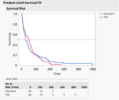

the out put showed as the attachment picture. Could you please to correct the script?

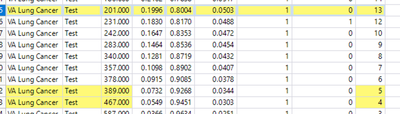

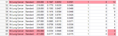

following up on the "inflated" at risk number.  Using your script (thanks!) on the VP Lung cancer dataset, I get 1 additional at risk numbers for 400 for the standard group and 200, 400, 600, 800 for test test group.
looking at the data table, values with exact timepoint (200 for standard - first pink row) shows correct at risk number, however for when there is not an exact match, such as 400, 600 and 800) current script is brining in the number before the specified time point. it would be great if scripting can fix these cases.
