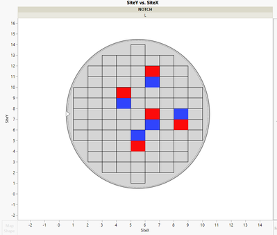

I'm trying to add maps to my graph builder plots and I need to be able to create a dependency based on the value included in Group X.  My plan is to have a semiconductor wafer notch orientation be the Group X value and depending on which value is present, invoke the appropriate map.
Variables( X( :SiteX ), Y( :SiteY ), Group X( :NOTCH ) ),

If you are using shape maps, I do not believe you will be able to have different maps for different values of your X Group column.

This will most likely require scripting and how it should be scripted depends on your use case. For example if it has be dynamic managing the groups can get quite annoying.
