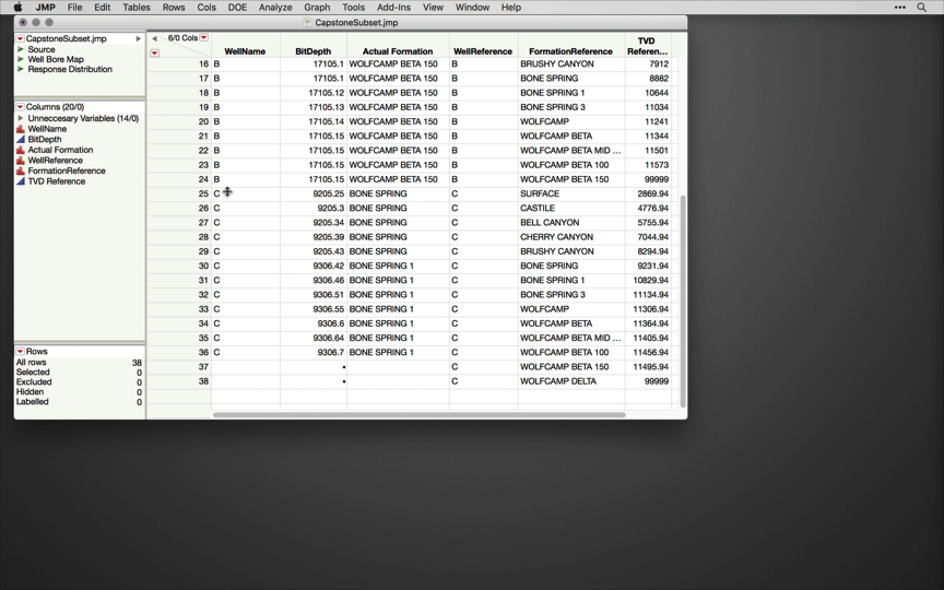

Thanks for this but I'm afraid I'm struggling with how I would apply the set values when they change.  I made a subset of my dataset that might help address what I'm trying to do.
The primary concern to remember is that the "WellName" and "BitDepth" are 8 million rows deep and "ActualFormation" will be as well if/when we can get a formula to work.  "WellReference", "FormationReference", and "TVDReference" are all about 2,000 rows deep with between 10-14 different formations and corresponding depths for each one.
In the attachment, the "ActualFormation" column has been manually completed to show what I need the results to do over the full 2mm rows.
Lastly, to recap the conditions, I need the "FormationReference" for a given cell to be returned when 1) WellName = WellReference and 2) where "BitDepth" < "TVDReference".  For condition #2 I'm assuming that JMP would return the first cell reference from the top as it works its way down since there will almost always be a couple formations that meet 2 conditions.

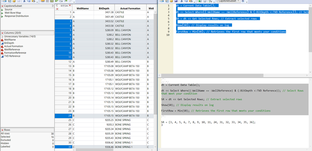

Based on the conditions that you described - doesn't this do what you are after ?
dt = Current Data Table();
dt << Select Where((:WellName == :WellReference) & (:BitDepth <:TVD Reference)); // Select Rows that meet your condition
SR = dt << Get Selected Rows; // Extract selected rows
Show(SR); // Display results on log
FirstRow = Min(SR); // Retrieves the first row that meets your conditions
Best
Uday
jlrouquette
Level III
Re: Return a Specific Row With Multiple Criteria - For Beginners
Yes and no.  When I run it the entire "Actual Formation" column (top to bottom) fills with 3.  The good news is that the 3rd row down in the "FormationReference" is the correct reference for the first row of the main dataset.
For this to be perfect it would still need to 1) find different results as the formula works it way down the sheet i.e. the 5th row should have shown as 4 rather than 3, and 2) ideally, I would like it to return the actual name rather than the number (3 would equal Bell Canyon and 4 would equal Brushy Canyon.
I could technically manage part 2 there with recoding or something similar but there are still >2,000 rows in the formation dataset I would have to manually change.
