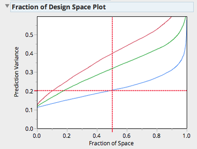

The difference between the two designs that you have found in the Table of Designs is that the first 28 run design is actually a Resolution V, 16 run fractional factorial along with the 2X5 = 10, axial points and 2 center points for a total of 28 runs. The 44 run design would be the full factorial 32 run design plus the 2X5 = 10 axial points and 2 center points for a total of 44 runs.
A fraction of the design space plot is shown below to illustrate the variance of the 28 run CCD (RED) vs. 44 run CCD (GREEN) vs. a RSM design generated using the Custom Designer for 44 runs (BLUE).

Can you interpret the graph in your repsonse to ajanda?  thanks.

Fraction of Design Space Plot
The Fraction of Design Space Plot shows how much of the model prediction variance lies above (or below) a given value. See Fraction of Design Space Plot. This is most useful when there are multiple factors. It summarizes the prediction variance, showing the fractional design space for all the factors taken together.
