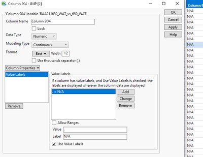

in Can I replace missing values in Numeric column with "N/A" string?
mikedriscoll
Level VI
Re: Replace missing values with 0
Use value labels to do that. Right click on column header, go to column properties, select Value Labels. Then put a period in the value and N/A in the label field as shown below. Then click add, and then ok.
To script it, follow the log recorder of above steps...
Data Table( "DT name" ):Column 904 << Value Labels( {"." = "N/A"} ) << Use Value Labels( 1 );
