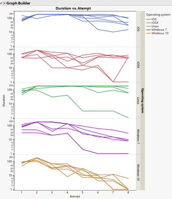

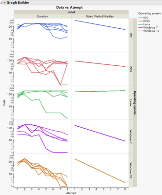

First is a plot of the data: Duration vs. Atempt, grouped by OS, overlaid by Computer ID. So by OS, they all present a downward trend. Windows10 machines do stay tightly. Other machines stay more or less stay together by OS. IOS and Linox have relatively more right censored observations. So a preliminary answer to your interest is that Atempt and OS matter.

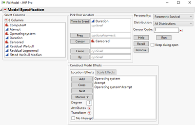

Now I attempt to fit a model. Based on what I see in the plot, a Parametric Survival analysis should be appropriate. So the setup is to see whether I can fit a distribution to Duration, while the location parameter of the distribution is a linear function of the effects. The Scale Effect tab is empty, so I am not considering the scale parameter of the distribution is a linear function of some effects, but it can be tried later to see whether it matters.

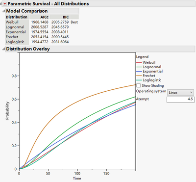

The report says Weibull is the best fit, followed by Lognormal. Also individual distribution reports show effects are significant.

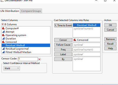

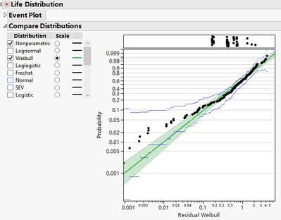

I then save the residuals from Weibull and Lognormal results back into the table. The use Life Distribution to look at them. Notice when put Residual into the Y role in Life Distribution, the Censor column needs to go to the Censor role, like what's in the following screenshot.
Analyze the Lognormal residuals similarly and compare the two reports. Weibull does seems to be a better fit, because linearization seems to better fit Weibull. Lognormal has a more significant kink.
Then from the Parametric Survival report, I save "Quantile Formula" from the Weibull result. When it prompts for "probability", enter 0.5, for the median. Now the data table has an extra column, and I name it "Fitted Weibull Median". Then I stack "Duration" and "Fitted Weibull Median", and get a new data table, so for every observation in the original table, I have a corresponding predicted median.
Use Graph Builder to put data and predicted values side by side, the model looks pretty reasonable.

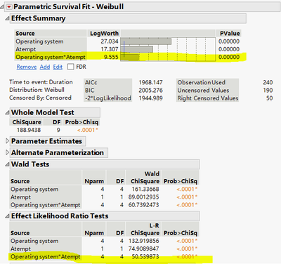

The Weibull result shows the interaction is significant. See the highlighted places in this screenshot:

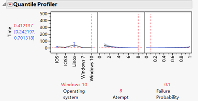

For here, I suggest using either Probability or Quantile profiles in the Weibull result. You need to turn them on in the Weibull result menu. Take Quantile profiler as an example; see next screenshot.
I fix Failure Probability = 0.1, and change OS and Atempt. So for this particular screenshot, the y-axis read off says: for Windows 10 machines, at 8th Atempt, 10% of machines will finish the operation under 0.412137 unit of the time measure. Then change OS or Atempt, or both to compare different scenarios. Fixing probability is the key to keep comparisons clear. Given OS and Atempt, the curve in the third frame, quantile curve, always go up.

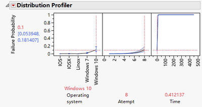

Similarly, for Probability profiler like the following. It reads: by 0.412137 time unit, at 8th Atempt, 10% of Windows 10 machines should complete the operation. Then compare scenarios by changing OS and Atempt or both. Also fixing Time is the key to keep comparisons clear. The last curve, distribution curve, always go up.
