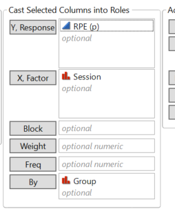

Is it adequate to do this in the Fit Y by X platform? The response variable of interest on Y, and "Time" (session in my case)) on X? I prefer this way making it easy to do post-hoc test directly in the same platform.
Here I can also fit BY group. While there are two groups in the project I primarily want to analyse these separately (one model for one group, one for the other, not interested in the interaction here, while it might be a secondary analysis).
I.e.

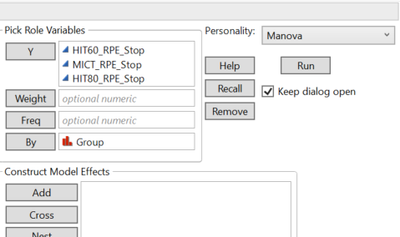

However, it can also be done in the Fit Model approach. In the MANOVA approach, I would just put the three time points on Y and nothing in the model effect (potentially BY group). This seems to have higher power. Is this adequate?

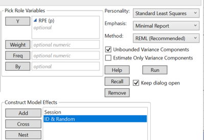

In the Fit model univariate approach, I would put the response variable as Y and "Time" aswell as subject[Random effect] in the model effect? This seems seems to have even slighly higher power (smaller P for same data).
 (And potentially by group)

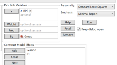

Or perhaps, this the way to do it, not puting ID as a random factor, and keeping the Least Squares personality?
Which gives the effect tests for Time, and giving the possibility for Tukeys and similar contrasts.

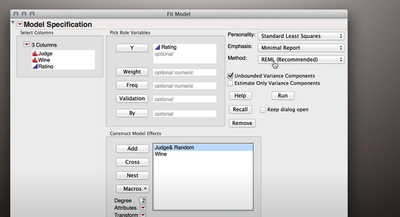

I guess this I want to do, as Paris in the video of One factor repeatead measures analysis.
