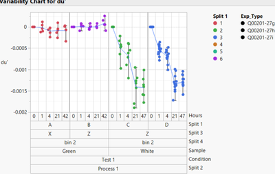

Figure 1: example of X-Y plot with manually added row legends. This analysis contains 4 plots. Legends were added by pressing CTRL + Right click.
As a part of EDA we constantly need to explore different categories (color by split in this case)

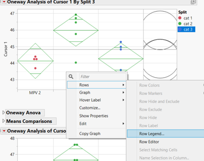

Figure 2a: right click options for adding legends. CTRL + right click applies changes to all plots simultaneously.
Figure 2: right click options. Remove usually removes legend
CTRL + Right click would apply changes to all plots. I.e Adding legend to all plots simultaneously works with CTRL + Right click. But for removing legends, CTRL + Right click -->  REMOVE stopped working for JMP18. It used to work for JMP16.
