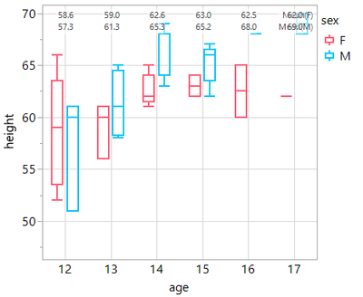

The legend of the caption box is partially redundant in combination with the legend on the right.
In addition, it collides with the numeric entries.
Is there a setting to hide the legend of the caption?
dt = Open( "$SAMPLE_DATA/Big Class Families.jmp" );
gb = Graph Builder(
	Graph Spacing( 4 ),
	Variables( X( :age ), Y( :height ), Overlay( :sex ) ),
	Elements(
		Box Plot( X, Y, Legend( 4 ) ),
		Caption Box( X, Y, Legend( 5 ), Summary Statistic( "Mean" ), Location( "Graph per factor" ) )
hogi
Level XIII
Re: Remove Caption Legend
workaround via JSL:
segs = Report( gb )[FrameBox( 1 )] << find segs( "Text Seg" );
segs[1] << set text( "" ); // the caption box legend
gb << set dirty;

workaround via JSL:
gb << set dirty;

Hm, no real solutions?
Then I will mark the workaround as a "solution".
