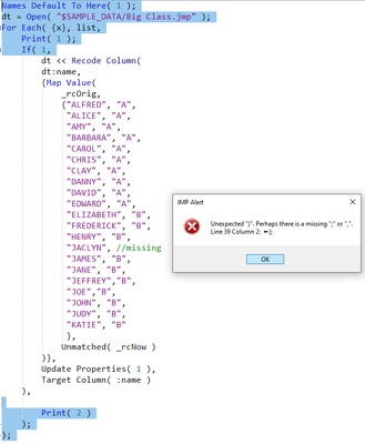

Reformat Script in JSL Editor is very helpful to get the code with a formatted structure.
Often it helps to find bugs in the code and to keep the overview.
But sometimes, it's the opposite.
Is there a way to protect code in a specific area from being shuffled by Reformat Script?

jthi
Re: Reformat Script - Protection some code?
Select only part of your code and then reformat the script
-Jarmo
hogi
Level XIII
You mean: don't select some code around the protection area such that the remaining code gets consistent, then trigger Reformat Script?
Unfortunately, doesn't seem to work :(

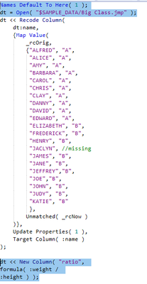

txnelson
Jarmo's suggestion works well, however one has to reformat syntactically valid JSL
results in reformatting only the selected parts of the code
Jim

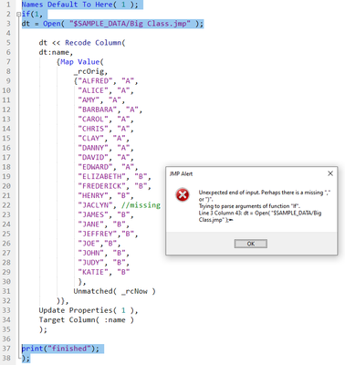

hogi
Level XIII
Hm, syntactically valid JSL code - reformat works if I delete the code in the (non-selected) protection area.
So, the remainder seems to be OK.
I think the actual problem is:
The two pieces of code - above and below the protection area have to be - separately -  syntactically valid JSL code.
i.e. the protection area has to be on highest level - e.g. a whole function.

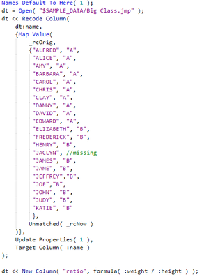

txnelson
Good catch.
There is a work around.  The
     Advanced=>Comment Block
does not change the structure of the code, it simply comments out a highlighted section of code.  If you Comment Block, then Reformat the JSL and then highlight and
     Advanced=?Uncomment Block
you will achieve your goal
