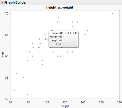

Hello,
Sometimes dataset may contain overlapping points. Default mouse over hover gridlet is showing the number of overlapping points (N) and some other information (see example image below from big class.jmp dataset).
I am interested in to get this information also be utilized in textlet or graphet script. How do I get hovered rows to list? I can use following syntax for selected rows but well,  hovering does not make selection. And as far as I know, there is not "Get hovered rows" function. Any suggestions?
selected_rows = as list(dt << get selected rows);
Following returns the first row of the overlapped rows. How can I reference to underlaying data point(s) eg in For-loops?
:height[local:_firstRow]

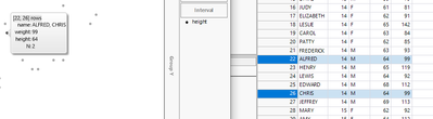

Very quick example here:
Names Default To Here(1);
gb = dt << Graph Builder(
	Variables(X(:height), Y(:weight)),
	Elements(Points(X, Y, Legend(1))),
	SendToReport(
		Dispatch(
			"Graph Builder",
			FrameBox,
			Set Textlet(
				Setup(
					expr = Parse(local:_where);
					local:r = local:_dataTable << Get Rows Where(expr)
				Markup("{local:r} rows")
(I clicked on the point to highlight them in data table)
	SendToReport(
		Dispatch(
			"Graph Builder",
			FrameBox,
			Set Textlet(
				Setup(
-Jarmo

Hi Jarmo,
Thanks for your suggestion to read the documentation more careful and your quick example. With this help, I understood better how the Hover Label Execution Context Variables works (especially _where). I was able to incorporate this concept to my application. Thanks again,
