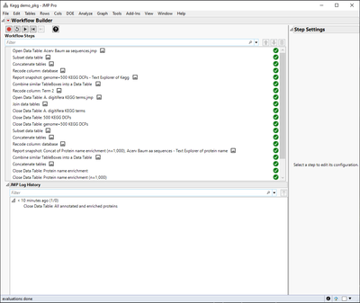

I have a quandary that mainly gets back to generalizing a workflow (which I discussed at length with Jordan Hiller). In the attached workflow, there is a key step in which analytes identified by one platform are placed into a new data table via the "make into data table" command. The issue is that, as far as I can tell, I cannot script it to where a specific name is given to the resulting table; it will simply be called untitled 1 (or higher, depending on how many windows I have open). At the very end of the script in question:
"Make Combined Data Table;
obj << Close Window;")
could I simply add a line to give the to-be-created data table a name? If so, then I could correctly "call" this table in subsequent steps. I think you will have a better idea of what I mean when you run the Workflow package.

And the answer is: yes and no. Yes, you can insert "Set name("new table name")" into the script in question, and it WILL correctly name the new table. Strangely, though, it still causes an error in the workflow that is UNrelated to the fact that the table name has changed (which is easy to modify). "Name unresolved obj" is the error. There might be a way to circumvent this but regardless, I think it was worth putting in a Wishlist request, and I imagine this would be a relatively easy fix/update.
