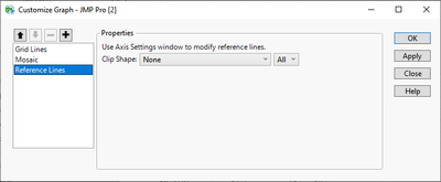

If you double-click on the axis after the reference lines disappear, are they still shown in the axis dialog?  If so, you might want to right-click in the graph frame > Customize to check the ordering of the frame contents.  The ordering should also be retained as part of the script, but if it is not then the data elements may be drawing over the reference lines:

After switching a column with the column switcher, I did as you asked and found that, indeed, the reference lines were gone from the dialog box.  The graph frame > Customize items were in the same positions, with nothing changed.
